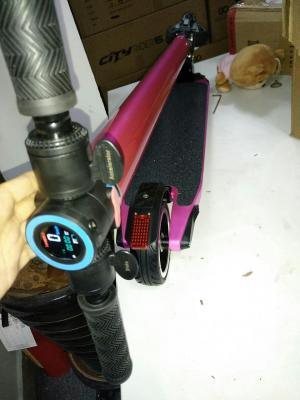

NextDrive2 Alloy SHULZ; E-scooter Alloy 36v
