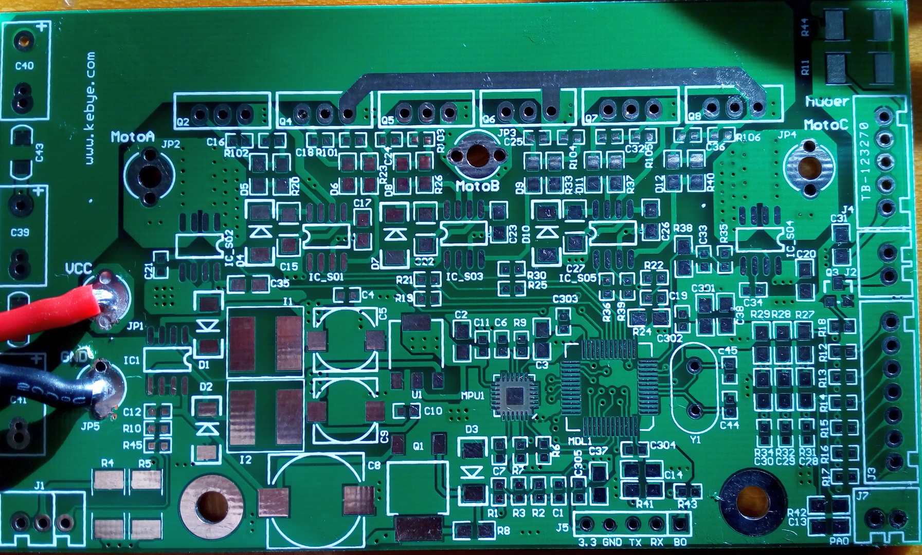

awakekiwi
Success! (Almost) finally for my little upgrade project.
First a quick recap. I had a chinese direct generic 550watt EUC with usual 18km/hr top speed, standard pedal rising and annoying beeps.. but a good performer.
Been the hacking geek and not satisfied with the speed I ordered a 30 km/h microworks built mcm control board (30BS), with bluetooth. It looked quite different from my original board (which had no bluetooth). Sadly it wouldnt ride, after many combos of hall sensors and power leads I gave up and went back to my original board, but then while installing some LED lights I shorted out the board and was left with no ride!
So then my choice was to buy one of the generic 18km/h boards available (18B) or try the 24 km/h microworks board that looked almost identical to my old board. I decided for the price ($50 NZD incl shipping) it was worth the gamble for higher top speed.
So it arrived today just one week later, in a very small cardboard box with almost no packaging, and i hooked it up using standard red yellow green blue black for hall sensors and yellow green blue for the power wires.. no go.. violent acceleration and calibration wouldnt engage using the two calibration wires. Big sigh and decided to keep trying combinations, did all hall sensor combos (6) and then decided to swap green and blue wires on power leads and hall sensors.. bingo! These seem to be the two wires that are most commonly swapped in different manufacturers. this time however i also needed to swap the hall sensors green and blue also. With the 30BS controller it was swap green and blue power and leave hall sensors as per spec. So even with different controllers from the same manufacturer then wiring is different, even though they send you the same wiring manual for each and tell you that the 24B and the 18B model wiring is the same.. um.. its not!
Ok so whats strange so far is that the calibration doesnt work. I cant get it to calibrate as per manual. IE the wheel doesnt spin and then give a long beep to confirm successful calibration. It just pauses and then beeps saying calibration didnt happen. But it rides quite well so far.
Odd thing is that, well its night time now and I didnt have a bike helmet handy so I wasnt willing to push it too fast, so tomorrow I will have a ride in daylight with helmet on and phone gps to test the speed. Because in my test ride I wasnt able to get the pedal to rise and I seemed to be going about 20km/h, and wasnt prepared to risk any faster without knowing what was going to happen, because it seems that when I hit approx 20km/h it tilted slightly forwards rather than backwards! this was quite disconcerting! maybe im imagining it because im used to obvious tilt back from my old controller or maybe it is not behaving correctly.. but im happy that its ridable and definitely way faster than original model.. im just curious to see if there is any top speed because holding the wheel off the ground and tilting it forward it accelerates, starts beeping at a certain angle but never cuts out no matter how far i lean forward.. this is weird also.
So sorry this is so long, I just figured Id save having to answer a whole bunch of questions and just give as much detail as possible.
If I can get it to calibrate i`ll feel a lot safer about testing its top speed.
But im pretty excited to have it running this well with tons of torque!
In the pics is original blown controller on the right and new one on the left. They look identical more or less. Interestingly this controller is sold for a 16 inch wheel but my wheel is 14 inch. Guys on russian forum said thats not a problem and they have used 16 inch controllers on 14 inch wheels.
Im wondering if I should keep trying hall sensor and power cable combinations in case I still dont actually have the correct configuration for the controller to engage calibration?

kib
Здравствуйте!
А что, тема заглохла?
Для интересующихся есть такое фото:
Еще изучаю формат пакетов от контроллера, вычислил еще не все. С командами от приложения к контроллеру разобрался.
