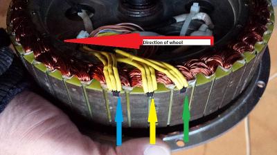

Larseren
Hi,
I'm having problems with the mini-e and my motor I am running 16S 4P hobbyking lipo(4S hardcase), I can complete the autodetect cycle and get the successful message but the motor will only turn very rough and noisy.
Youtube link to noisy motor: https://www.youtube.com/watch?v=v6EIumyg3Ag
Youtube link to successful autodetect cycle: https://www.youtube.com/watch?v=fKuh_eBzFc8
When I go to the health monitor I can see the sequence of the halls and it goes H6,H5,H4,H3,H2,H1,H6,H5....... for about 1/2 turn of the wheel and then goes out of sequence.
Youtube link to hall sequence: https://www.youtube.com/watch?v=3MFtl4c2f5U
I can see that this is mentioned in the FAQ with this text:
"a) Navigate to the health monitor (from the main screen to the left)
b) slowly roll the wheel forward and watch the digit after the inscription "Halls: xxx, Hy". Figure "y" should vary according to the scheme or 1-2-3-4-5-6-1-2-3-4-5-6 - ... or 6-5-4-3-2-1-6 -5-4-3-2-1 - ... and the three digit "x" represent the logic levels of each of the three hall sensors.
If, during the motor rotation numbers "y" sometimes takes a value of "0" or a different sequence of numbers, the hall sensors are not working correctly, or motor sensors have an angle of 60 degrees. (If 60 degrees - then you need to flip one of the hall sensors in the motor, not all, but a specific sensor)"
The hall sensors are brand new ss411a and are tested with a voltmeter so they function as they should.
Maybe the motor is 60 degrees even though it states 120 degrees in the link, there is also a place where there is a small gap between the magnets.
Here is a link to my motor: http://cnebikes.en.made-in-china.com/product/evVnETAlvUWb/China-60V-1500W-E-Bike-Hub-Motor-with.html
Here is a pic from the inside of the motor that shows the hall placement(blue hall goes to pin 1 on Adaptto connector, yellow to pin 2 and green to pin3)
Is there anybody out there who can help me with this issue or is my motor incompatible with the mini-e?
Thanks from Larseren
mevial
This is not problem, just change "direction" in the controller settings and rerun autodetect. In the 60° motor You can see some "H0" positions and "HALLS!" error at the main screen.

Larseren
#1202
Я кажется скоро поверю Задорнову.
[/quote]
Hi again, no I am not a comedian/satiric, I have tried changing direction and rerun autodetect(I can see the !HALLS! message many times but if it start at a certain point it will turn). If you look at the hall sequence video about 1 min 15 sec the sequence suddenly goes 6,5,4,3,4,3,2,1..... this makes me think of angle or the gap in the magnets are a problem.
And believe me I have tried many different combos of hall angle, wire revers, direction+/- etc.. The best result I have is what it shows in the running motor video and I have tried  adjusting angle corr while it is running but without any result to speak of(I can see the A(current) fluctuates a little).
The motor goes fast in sensor less mode and functioned with the old Chinese controller
mevial
Sorry, this is a russian joke.
I just watched all your videos. You have halls error after takeoff throttle, while motor angles is incorrect, don't mind about that. If You need  sequence H1,H2,..H6,H1 you just need exchange any two halls signal wires in the connector. Or just make manual detect and angle correction via "advanced" controller settings. I can't explain with text, but I recorded a video:
http://youtu.be/gozLnSP4rSc
