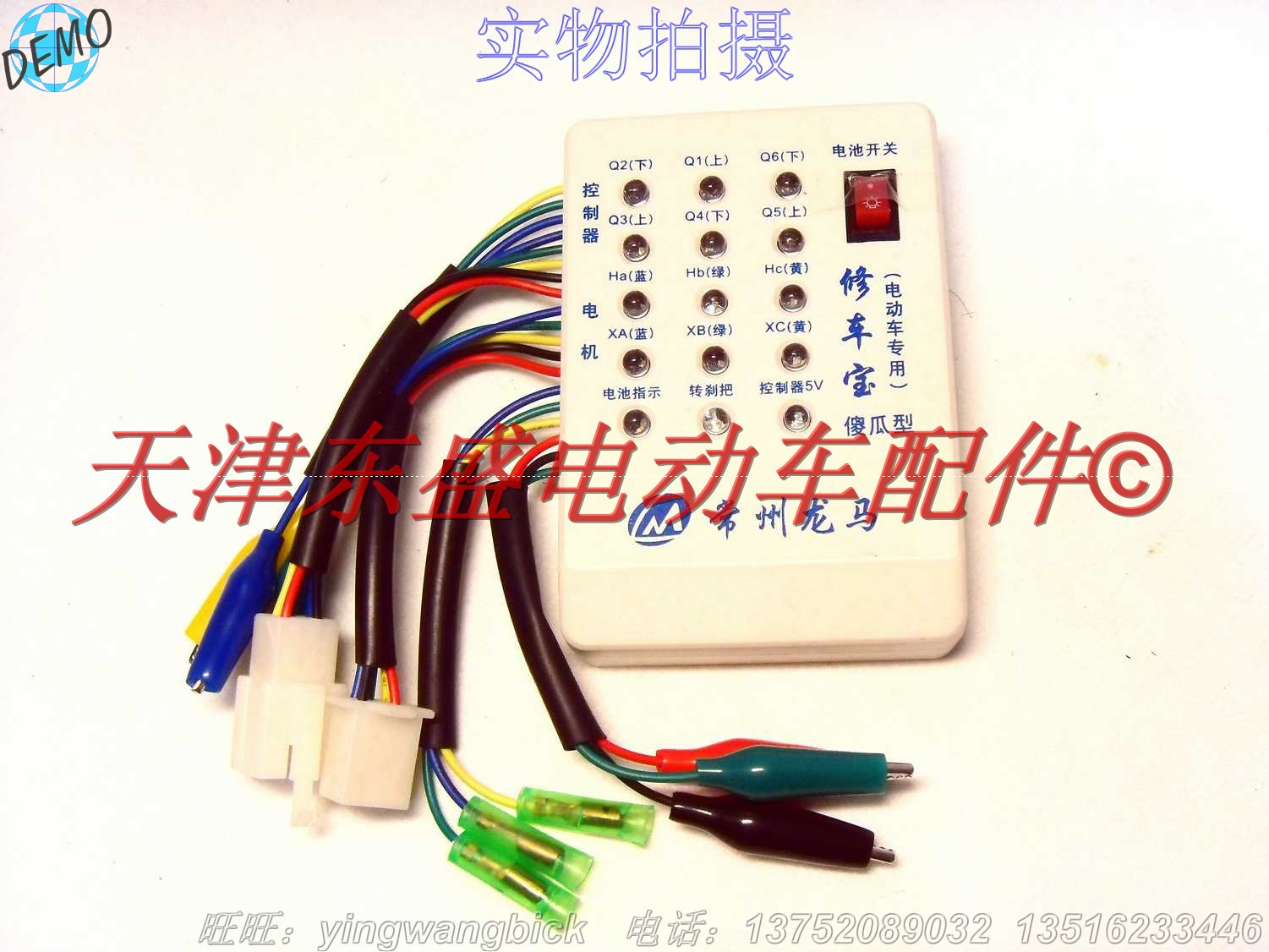

вот попался "шустрый" многофункциональный тестер, чето типа этого
ЦитироватьRapid detection of the good or bad of the brushless controller
Rapid detection of the good and bad of the brushless motor coil
Rapid detection of the good or bad of the brushless motor Hall
The rapid detection of the phase angle is 60 degrees or 120 degrees,
Rapid detection of brushless motor phase sequence ABC and abc colors
Rapid detection speed turn good or bad (precise measurement) (turn detection indicator green light is off and then the red light for a good turn)
Quick check brake to be good or bad.
Multifunction electric car repair the the detector for 24V, 36V, 48V, 60V brushless controller, brushless motor coil, brushless motor Neihuo Er, turn to the detection and brushless motor angles distinction.
и всего то за  150 рублев. научится бы еще пользоваться :)
